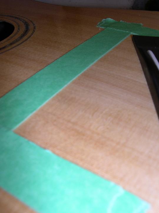

For a classical definitely FP before fitting the bridge. Ditto for a steel string. If you want to mask off the bridge area mask off to a few mm shy of the bridge outline and trim back shellac to same with scalpel once FP is done. If you mask right to the outside of the bridge footprint then there's a chance youll lift shellac and end up doing a patch up job with the shellac. It also leaves room for minor adjustments to final bridge position if required.

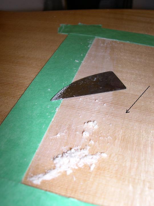

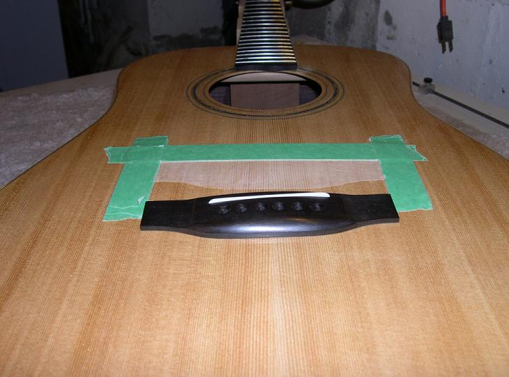

I'm like Jim I'll FP without the bridge in place. Once I've settled on the bridge placement I'll dam the area with tape as in this picture.
Then mark the area with a sharp knife point as seen in in this picture.
Finish the scraping and then I'll glue the bridge in place.
